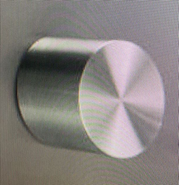

can someone tell me how I can create in KeyShot this reflection effect starting from the centre of the flat side of the cylinder?
I ask you to look at the photo to better understand what I mean.
Thanks
Hi @alessandro.barberis it’s basically just a radial brushed surface which give you such reflections. If you make an image in Photoshop, add noise and you do blur > radial you get a nice texture which you can use. Combined with the light reflections and the metal it will look like this.
Hey! What you’re referring to is called Anisotropy. Here are a couple of videos that show how to do this:
I hope those help!
